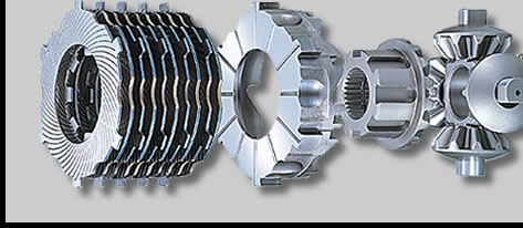

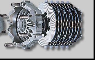

интересуют альтернативные производители диффов
на 53-й есть блокировка у CUSCO - Type RS L.S.D.
http://forum.minipeople.ru/index.php?act=a...ost&id=2013
Out of the three LSD systems, this one is the most popular and intense. As soon as the throttle is pressed, the LSD system can be felt, operating like it's supposed to. This can be used by beginners to advanced enthusiasts, for a wide range of skill levels. Unlike those harsh LSDs, the Type RS does not make virtually any snapping noises during normal turns. This LSD system wears down very slowly, and is known for its long lasting qualities.
http://www.jdm-option.com/eng/pr_CUSCO/lsd.html
