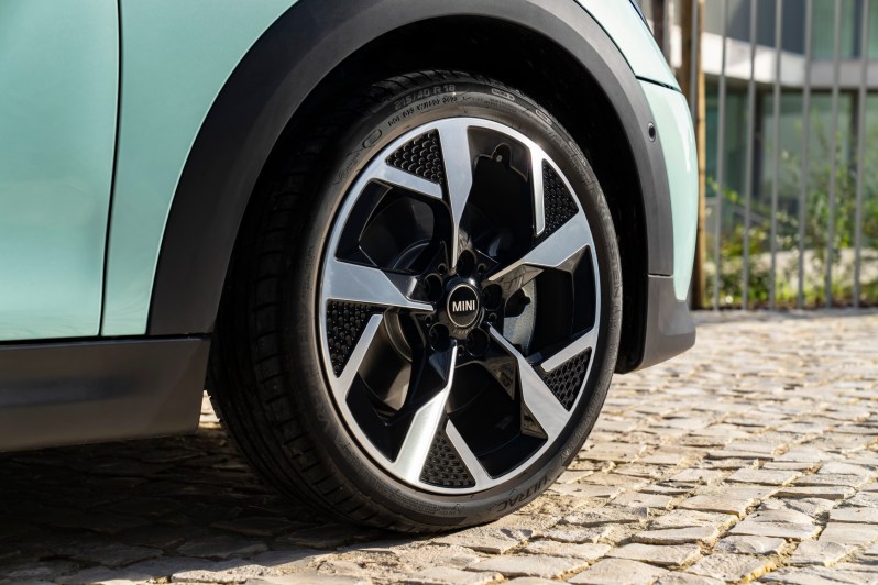

IMG_0281.jpeg?resize=798%2C532&ssl=1
J01 vs the F66 – Wheel Offset and Track
Now let’s take a look at wheel offset, track and turning circle. Again interesting differences here expose the very different underpinnings of these two cars.
Performance2024 J01 MINI Cooper SE2024 F66 MINI Cooper S
Wheel offset – front40 mm 47 mm
Wheel offset – rear40 mm 47 mm
Track – front1538 mm1499 mm
Track – rear1538 mm1499 mm
Minimum turning circle10.8 m / 35.411.1 m / 36.4 ft
The better numbers are bolded. All measurements are taken from the EU market. Note that there are some differences in the way the US measures weight vs the EU.
